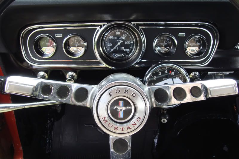

    So first up, bug fixing, I fitted Ford Racing classic style gauges in the car (first part of the hot rodding process) and they look awsome, only problems are the speedo is reading well too high and so is the fuel gauge. First job, fix the fuel gauge, I achieved this by fitting a 36ohm resister in the sender wire inside the trunk comparment. Job done. (obviously there was alot more working out and mathes involved here but I wont go into that) Next job will be to sort the speedo out and also fit the trunk lid springs that i've had sitting under my bed since June 2009. I had these powder coated along with the trunk lid hinges but just never got round to fitting them, but both of these jobs can wait till next weekend. I also made a start of flushing off the engine bay, this wont ever get done properly until the engine is out, but for now im going to do the welding bits before I put all the interior in. First job was the hole were the original heater blower fan sticks through, I cut out a large square out the bulkhead, made up a piece of flat steel to fit in the hole, welded it in and then ground the welds flat. Next I removed the original screen wash bag bracket. I have yet to get rid of the holes for the coolant pipes that feed the heater but thats the next job on the list to do. Another thing I have started is repainting the ash tray. I have a little supprise that im doing with the dash area of the car which I think will look great but i'll let the pictures speak for them self once its done, but so far I have bare metaled the entire ashtray inside and out, welded up a hole that had been cut in the back off it, sprayed the inside of it with black hammerite and sprayed the outside in primer. Hopefully next weekend i'll get the colour on it if I get a chance.

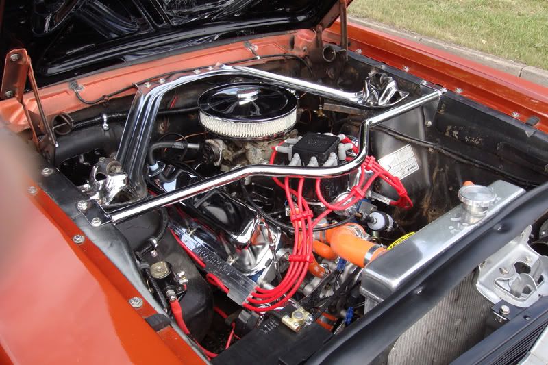

    This is the new balancer, its a Powerforce plus 28.4 ounce harmonic balancer, at the same time I fitted another new radiator, same one as I was previously running, its a scott drake item, highly recomend this, bolts straight in and cools the car lovely, also fitted a flow kooler 180 degree high flow thermostat which is also doing a great job:
    Here is the welding i did in the engine bay, decided im not going to run any heating, i dont use the car at all on cold days, its a summer toy so thought id just get rid of the holes:
