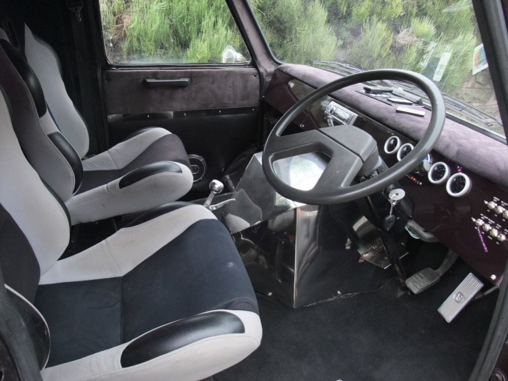

Here are some more Pic`s of the Interior ; -
The Steering Wheel has been changed since these pictures were taken, and the New Boss & 3 Spoke Chrome/Leather Mountney S/Wheel are both now in place. (Dirty Marks have been cleaned off the seats too. Lol !!).
