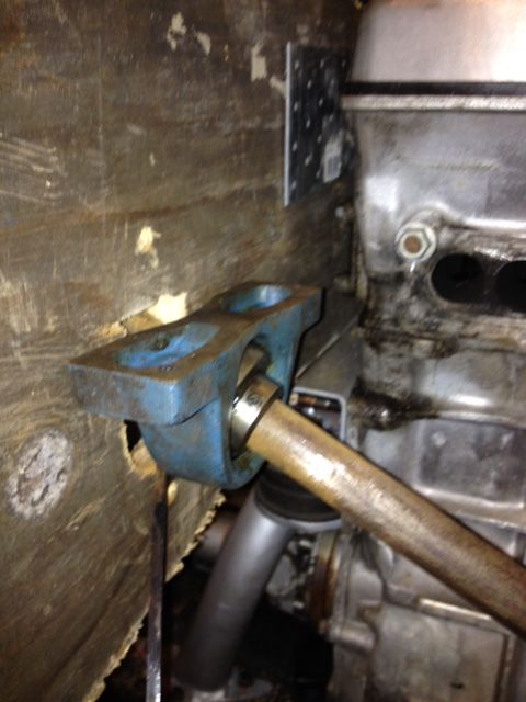

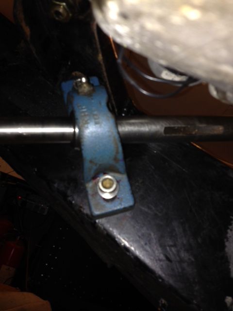

    Quote Originally Posted by ivanhoew View Post
    hoke a kokay ,
    well struggling to get a bit of work done in the christmas melee,you may remember in the last episode we were investigating a way to support the shaft of steeringness.
    i had a hunt in the crystal cave of wonderment (spares shed/greenhouse) and found a shaft with a pulley on it and a couple of plummer blocks . this came from a old huge compressor i scavenged ,and then changed motors and stuff on , and i was left with this jackshaft spare .
    now the amazing thing is , the id of the bearings ,was the same as a ) the od of the minor column ,and b) the od of the section of the taxi shaft i wanted to use .
    eg ...
    Robert
    Sorry to bother moi ...
    Those bearings ? are they now trapped on the shaft by the U/J's/welding ? or are they free to slide off one end ?
    regards Paul

    Quote Originally Posted by stormbird View Post
    Robert
    regards Paul
    No Bother Paul , always happy to have comments on here , especially questions , they can slide off the steering wheel end , or rather the shaft can slide downwards
