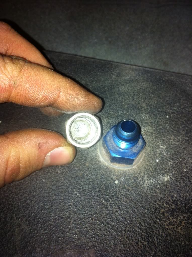

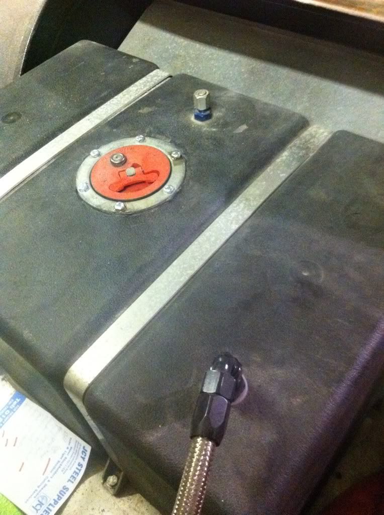

When returning fuel to the tank always do it to the top or the pressure of fuel in the tank can hinder it returning. Also use a hose size not smaller than the same as the feed line. One size bigger is better. This is because at idle your using hardly any fuel and the return isn't under as much pressure (force) as the feed line fuel. Therefore it needs an easier path to get back to the tank or it can affect the system.
Also if you direct the return fuel to the side of the tank so it doesn't hit the tank contents it will cut aeration to almost nothing. Mine has a 45* fitting inside the tank to direct the fuel onto the cell side. I stuck a bulk head connection in the boot floor to secure the breather line.
First pic shows just breather.
Second pic shows -10 roll over valve fitted.
