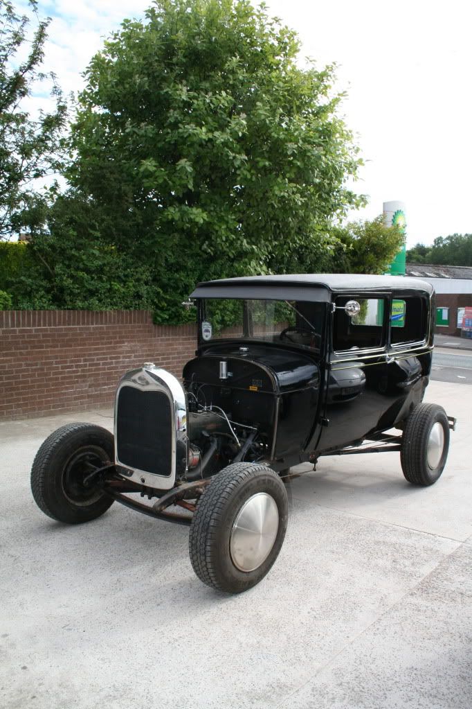

made a start on stripping the A so i can get the body onto the other chassis. it then means i can get all the pedals, steering and other bits in the right place, also it will allow me to get shot of the stock chassis giving me more room in the garage.
